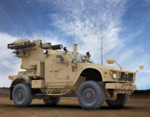

M-ATV with anti-aircraft missiles.

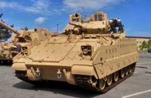

Bradley vehicle with anti-aircraft missiles.
Boeing has worked with Oshkosh to install the upgraded Avenger turret on an MATV armored truck – the older brother of the new JLTV – and with General Dynamics to install it on a Stryker. In each case, Leary said, the missiles take up the whole back of the vehicle, replacing the passenger compartment. These would be dedicated anti-aircraft vehicles.
The M2 Bradley is a little different. There the anti-aircraft missiles would replace the TOW anti-tank missiles carried on the side of the turret (and use the same room for reloads), similar to the old M6 Linebacker. The fire control systems would be integrated into those already on the Bradley, Leary said. The anti-aircraft Bradley would retain its 25 mm chaingun, its machineguns, and its capacity to carry infantry, so it could still do all its regular missions except for killing tanks and busting bunkers.
Leary didn’t say this, but it strikes me the Army today has far more ways to kill tanks than to kill aircraft. Converting one Bradley in every four-vehicle platoon would trade a tolerable 25 percent decrease in anti-tank missiles for a new and much needed capacity for air defense – without affecting the number of infantry or scouts. Stryker units and light infantry would still need to spring for dedicated air defense vehicles, but the heavy brigades crucial to any major war would not. US armor bristling with air defense might just make the Kremlin reconsider in a crisis.

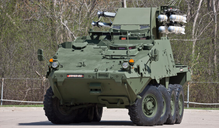

HUNTSVILLE, ALA.: If you fly Russian MiG fighters, Sukhoi attack jets, or Hind helicopters, your life just got a little harder — and in the event of war, potentially much shorter. At the Space & Missile Defense conference here, General Dynamics rolled out the latest variant of their eight-wheel-drive Stryker armored vehicle, with the troop compartment that’s normally in the back replaced with a Boeing-built anti-aircraft turret. Scroll down for our photos of the vehicle, dubbed the Maneuver SHORAD (Short-Range Air Defense) Launcher, or MSL Stryker.
Evolved from the Cold War era Avenger, which mounted Stinger missiles on Humvee, the new turret can mount a wider array of more powerful weapons:
AI-3s, a ground-launched version of the AIM-9 missiles used by US fighters, with significantly better range and maximum altitude than the old Stinger.
Longbow Hellfires, originally an anti-tank missile, made famous as the favored weapon of the Predator drone, and suitable for both ground targets and low-flying aircraft like helicopter gunships.
Hydra 2.75 inch guided rockets;
0.50 caliber machineguns;
and even low-powered lasers capable of burning out quadcopters and other small drones.
The vehicle on display at Huntsville’s Werner von Braun Center mounts Hellfires on one side and AI-3s on the other, as well as a specialized electro-optical sensor on top. But the GD Stryker is just one of a family of anti-aircraft vehicles that Boeing is developing with various partners, as heavy as BAE’s tracked Bradleys and as light as Oshkosh’s Joint Light Tactical Vehicles. A JLTV with anti-aircraft missiles and a machinegun will debut at the enormous Association of the US Army annual conference in Washington, DC this October.
The MSL Stryker’s turret, with two AI-3s (modified AIM-9s) on one side, four Hellfires on the other, and a sensor on top.
